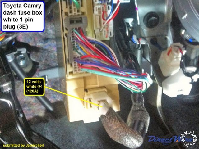

Posted: April 19, 2013 at 11:54 AM / IP Logged
The only constant I know for sure us a LARGE white wire on the fuse box.

Posted: April 19, 2013 at 12:51 PM / IP Logged
Thanks for the quick reply tonanzith. Where is the pink wire behind the fuse box dash fuse box, rear, white 56 pin plug (3A), pin 27 in relationship to the above mentioned white hot wire?
tonanzith
Gold - Posts: 603
Joined: July 18, 2008
Posted: April 19, 2013 at 2:14 PM / IP Logged
on the opposite side that the fuses are on.. should be rear facing the firewall. kind of a pain to get to. there is also a black ignition wire in the driver kick panel.
