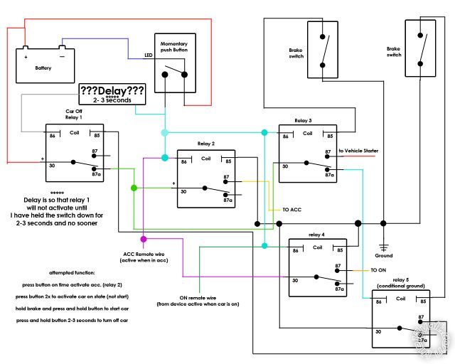

I am planning to add a starter button to my car. I have set up a diagram of what I am trying to do.
for those of you who know.   Will this work?
the picture show what it is supposed to do.
Right away I am unsure what I have to do so that a relay only activates after I have had a button pressed for 2-3 seconds.
I am also worried that it will drain my battery because one of my relays will almost always be active.
pictures would help as I am just learning all this...thanks
multi function starter button -- posted image.
Posted: April 29, 2013 at 7:27 AM / IP Logged
Your first relay could be replaced with a DEI 528t or similar giving you a delay on. you need to PM Kevin Pierson or Oldspark for further advice.
Much of that circuitry could be replaced with a Pic timer controller.

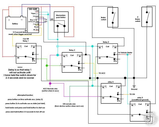

thank you howie ll...I understand the timer now
I modified my diagram to add the DEI 528t and get rid of my constant running relay....please tell me if this should would work the way I want.
I am feeling confident now that I have the timer
Just in case though.....lol....tell me what I should do to make this better.
thanks in advanced
