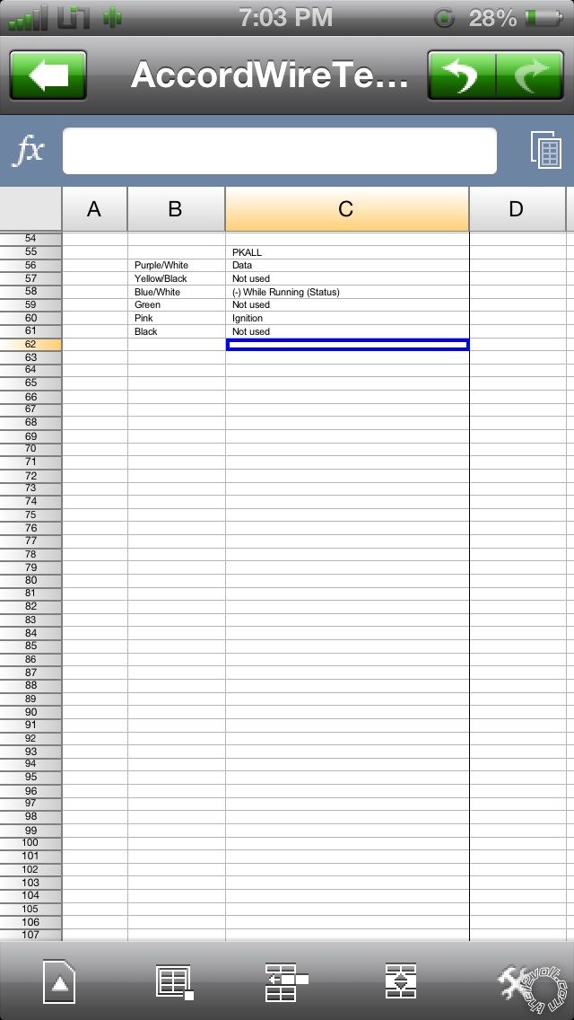

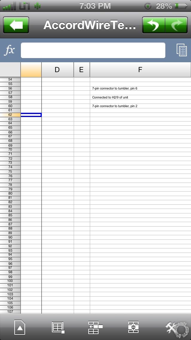

Sorry, I didn't pry into my wiring when I posted the chart. I did have the blue/white wire from the bypass connected to H2/9.
It's the factory alarm going off.
Now when you say diode separate, is that different than the diode isolate I did? Could you go into how I should diode separate H2/9 as well (cathode/anode position)?

viper 5904, keeps trying to start car - Page 2 -- posted image.viper 5904, keeps trying to start car - Page 2 -- posted image.

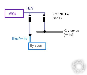

Posted: May 13, 2013 at 6:28 PM / IP Logged
Diode isolate/diode separate are the same.
Posted: May 13, 2013 at 6:36 PM / IP Logged
Here's the diagram:-

Thanks for the diagram!
I'll make the adjustments tonight. Now, when I reconnect everything, the car cranks and and panics. When I have all the connections in and corrected, is there something I should do to stop it, or will it stop itself? I disconnected my sirens and tried it and let the car crank, but even after the motor started, it kept going. The battery terminal was sparking like crazy as well, even burned some scars into the battery post. This just worried me because the hood is open, and hood pin is up.
