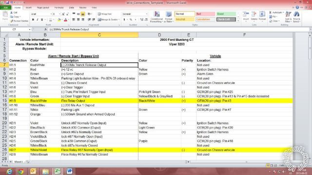

Posted: May 22, 2013 at 5:59 AM / IP Logged
I have uploaded list of current connection. Highlighted in yellow are ones that is not working. Any help will be appreciated I’m completely stopped

Posted: May 22, 2013 at 9:46 AM / IP Logged
I haven't yet looked up the alarms manual and your cars connections to verify but looking at what you've posted if its accurate, you have the black whit out to the car for dome supervision needing to see a + signal from the white violet flex relay wire but you have that wire grounded. If the info is correct then the white violet flex relay wire needs to be hooked up to 12 v +

Posted: May 22, 2013 at 8:23 PM / IP Logged
Thanks Gary. It's working now. I was confused I guess 00 mustang viper 3203 -- posted image. 00 mustang viper 3203 -- posted image.
