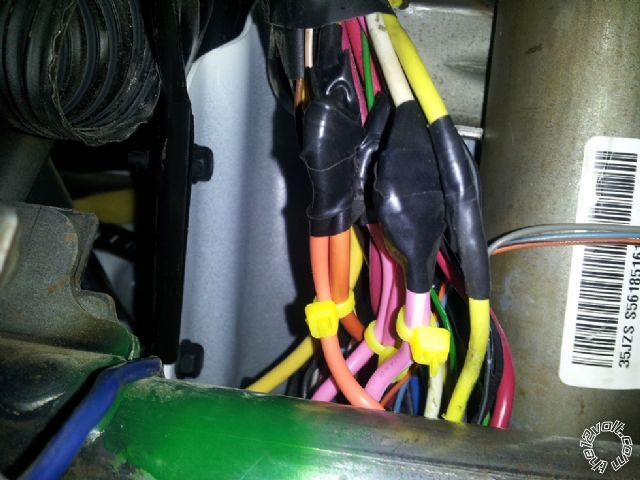

So, I am going to be installing the alarm in the subject line into my 2 door, stock keyless entry, 97 Tahoe. I have been searching all afternoon to avoid mistakes and have come up with my wiring guide after triangulation and weeding out the wrong. I have a few points of concern that I was not able to determine with searches. The concerns are as follows:
1. My vehicle NEEDS a second ignition wire. I will get this connection from H3 terminal 7, to the white wire in my ignition harness, but that is the flex relay output (car side of ign), when using this connection, do I need to cute the white wire and connect car side to H3/7 and ignition side to H3/8?
