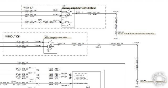

OK, now having done some more searching on this site I see that there are guides for exactly what I asked.2013 ford ranger, compustar 6300a -- posted image.
Can anyone tell me which system this is?

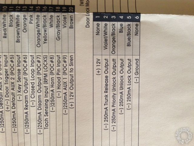

Posted: June 23, 2013 at 5:47 AM / IP Logged
And here is the controller diagram:

Posted: June 24, 2013 at 5:20 AM / IP Logged
Try a late Mazda pickup truck, the same vehicle and made in Thailand.
Posted: June 24, 2013 at 5:22 AM / IP Logged
Also can you display a legible version of the vehicle lock/unlock circuits ?
Can't make out what you've displayed.

Posted: June 24, 2013 at 5:57 AM / IP Logged
That seems to be the best image that I can do a screen grab on, but here is a close up of the switch:
C2PK29-5 goes to ground.
Good idea about the Mazda though, thanks.
Posted: June 24, 2013 at 6:02 AM / IP Logged
Terminal 6 but it appears like the Mazda to be a one wire resistive system aka multiplex wiring.
Test by cutting that wire then running a DMM set to 2K or more ohms range. One way, say lock should read 0 ohms, the other way say unlock 1k ohm or whatever, read the relay section here on central locking types, multiplex.
