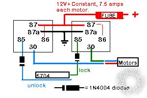

Posted: June 25, 2013 at 10:58 PM / IP Logged
Here's an old diagram of mine.
gregbbb
Copper - Posts: 82
Joined: February 22, 2008
Posted: June 25, 2013 at 11:30 PM / IP Logged
Thats what i got now but i dont have 87a  grounded i dont have 87a conected to any thing

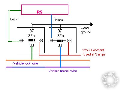

Posted: June 25, 2013 at 11:50 PM / IP Logged
That was an example, you wouldn't use 87a if you were simply say going from alarm's NEG (-) output to a type "A" POS (+) lock trigger that would be this:- type_a_locks.bmp
Note different way I've used the diodes, equally functional.
