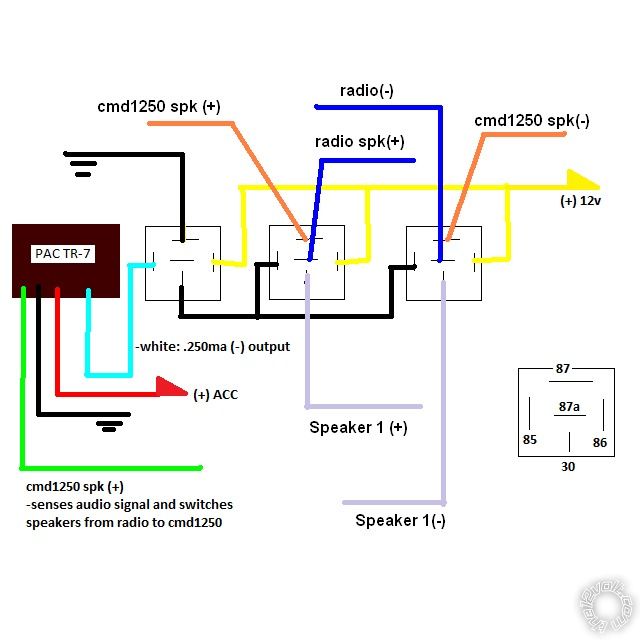

If the CMD1250 doesnt have a wire that goes to ground when it activates why couldn't you use a Pac TR-7 trigger output module that send a (+) trigger out to the relays with a audio signal and use the relays to break open the speaker wires? Just a idea.

Could you tell me hoe to build a relay switch. I have a ruff idea on how to do it. A list of parts would need to build the relay.

Sorry it took so long for me to get back to you. I've been busy at work and haven't had much time to do anything. I made a schematic of how the audio switcher would work. I only made the diagram for one speaker but you need two relays for each speaker that's being added. So all you need is some 18AWG wire, SPDT 30/40A relays (number depends on the amount of speakers in the system), and a PAC TR-7. automatic audio switch -- posted image.
