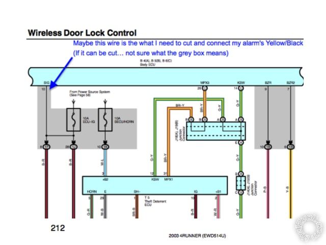

Does anyone have a wiring diagram for the "Door Control Receiver" or experience with this component or a solution to the problem?
If required, the alarm has a few different wires that I can use so that I can only have the key sense grounded during the cranking part of the the remote start:

So it seems that I MIGHT be able to make it work by only grounding the key sense during cranking, an then using the Yellow/BK wire to allow the keyless entry to work while under remote start. My problem, is I don't know what wire(s) I need to cut and attached the Y/BK wire to.
Wiring diagrams, info on how the factory keyless entry system is disabled when the engine is running, or other info would be greatly appreciated.

Posted: July 01, 2013 at 2:02 PM / IP Logged Link to Post Post Reply Quote i am an idiot
If you find the keyless module and find the wire that goes hot when Ignition is turned on, I am pretty sure that if you cut that wire so the module does not know the key is on, it should do what you are looking for.

Thank you. When I get a chance I'll look for the module in the D Pillar Driver's side and try probing it.
Anyone with wiring diagrams know where I can find the feed to that module up by the Dash. It appears to me that the "Door Control Receiver" connects to the Body ECU, which would be a much better place to tap into it, but I'm not sure which plug/wire combo I'm looking for.

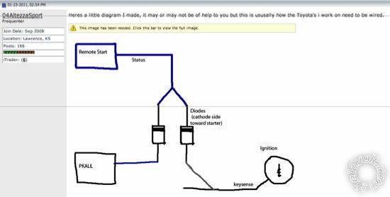

Posted: July 01, 2013 at 4:48 PM / IP Logged Link to Post Post Reply Quote howie ll
Key sense wire GREEN/ YELLOW (-) in ignition loom connect to your GWR or staus wire, if that's being used for the bypass diode separate.

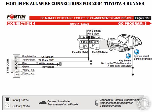

Posted: July 02, 2013 at 10:31 AM / IP Logged Link to Post Post Reply Quote pjbrownva
Howie,
Thanks for the info regarding Diode isolation on the key sense.
Right now, I've got:
PK ALL
Blue (GWR or Status -)   --> Remote Start GWR (Status -)
Green (Key Sense)        --> Ignition Barrel (GREEN/ YELLOW - )
04 4runner remote start w/factory remote -- posted image.
(Directions from Fortin for 04 4Runner)
I believe I don't need to diode isolate in THIS setup, because I'm not connecting the Remote Start's GWR to one connection on the PK ALL. Please let me know if I'm mistaken.
Below I've also attached a diagram from a Lexus forum (forgot the forum name) showing a proposed use with diode isolation. I'm assuming that this is the diode isolation you are referring to, but right now I'm NOT following this diagram, because I believe it's not needed. Again, someone let me know if I'm wrong.

Posted: July 02, 2013 at 11:09 AM / IP Logged Link to Post Post Reply Quote howie ll
The seond diagtram is correct, that's how I'd do it although I'm assuming the Fortin green wire is not connected to the blue GWR above it, meter via continuity if they are connected, diode as the second diagram, either method will work.

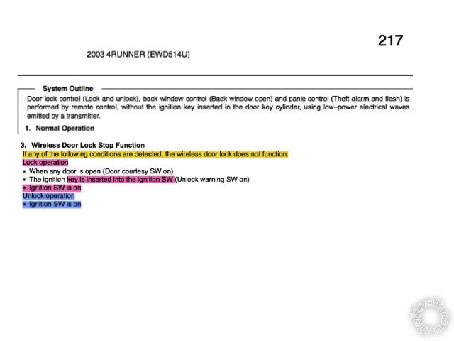

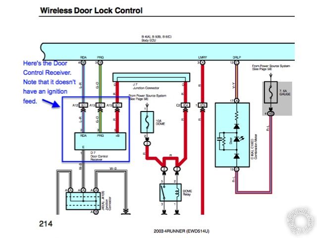

I thought I'd update everyone on my quest. The answer seems to be that once the 4runner is under control of the add-on remote start, my only option is to use the key to enter the truck.
I found a diagram for a "Door Control Receiver" which is housed in the Driver's D Pilar behind and/or above the rear tail lights. It has four connections which are:
Ground -- Always Ground
+12V -- Always at +12
RDA -- Data line sends coded pulses to send lock and unlock messages
PGM -- Used when programing new key fobs.
Those are the only four connections, so I don't believe that there will be a way to fool the door lock controller into thinking that the ignition is off while the car is running.   I *might* try tapping into the RDA line and see if I can read the pulses with some custom programming logic, and use that to trigger door lock, unlock etc on my own... but that project would be for another day.

Have you tried the key sense yet?

Sort of...
I connected the PK-ALL status wire to my alarm's BLACK / YELLOW (Neg during crank), and left the key sense connected only to the PK-ALL key sense output wire. So now my PK-ALL and my Key Sense both only go Negative when the Remote start is cranking the engine.
I also found documentation for an '03 4 Runner that states that the remote lock and remote unlock will not work if the ignition switch is "On". From the logic involved and the wiring diagram, it seems that the Body ECU will always receive the lock or unlock commands from the Door Control Receiver, so I guess here's what I *might* try.
The body ECU has a BLACK/ Red wire at pin 10 that is the secondary ignition, and it appears to be an input (sensor) wire. So I could try cutting that wire, and connecting it to the Yellow/Black wire (to keyless ignition input) on my remote start.
That SHOULD make the body ecu think that the ignition is off when the car is running under remote start.
I guess my only concerns are can I isolate just this wire (it's inside a grey box on toyota's diagram), and will the change have other negative consequences. I don't know if the Body ECU control anything truly important (like engine management). I see that it DOES control windows and locks and also the Anti-Theft system.
(Relevant pages attached and quoted below. Source: LINHSY from T4R.Org
Sorry for the images... not allowed to post PDFs yet.)
<quote>
System Outline
Door lock control (Lock and unlock), back window control (Back window open) and panic control (Theft alarm and flash) is performed by remote control, without the ignition key inserted in the door key cylinder, using low–power electrical waves emitted by a transmitter.
3. Wireless Door Lock Stop Function
If any of the following conditions are detected, the wireless door lock does not function.
Lock operation
∗ When any door is open (Door courtesy SW on)
   ∗ The ignition key is inserted into the ignition SW (Unlock warning SW on)
   ∗ Ignition SW is on
Unlock operation
   ∗ Ignition SW is on
<end quote>
