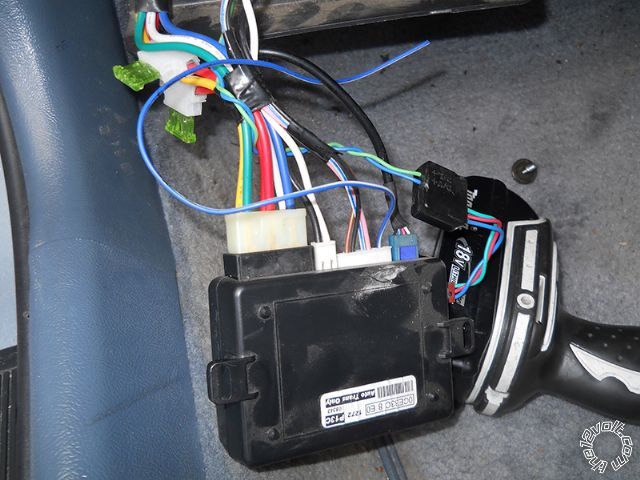

Yes, the Blue/White is the Tach Input. Think I would connect that to a good Tach source. Tach mode always
works best, especially in the colder climates. You can do that after you get everything else sorted.
The WHITE/ Blue goes to the cars horn wire. It should be easy to find. Here is the info from ReadyRemote :
Horn Trigger Black (-) @ steering column
That little black box with the Green, Blue and Red wires from the U1272 converts the lock outputs to (+) for your
door locks.
Those two Green 30 Amp fuses are the power to the R/S. There shouldn't be any special programming options
set, so a U1272 Factory Reset is OK to do. If you do the reset, then connect the Tach wire and it will auto-tach
learn the first time you start the engine with the key. Here is the info on a Tach source :
Tachometer PURPLE / White AC @ ignition coil
I don't see any VATS bypass, so maybe then did a permanent bypass on it already...
