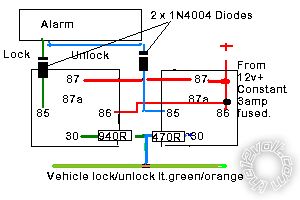

Here is a diagram from Bulldog Security :
http://diagrams.marktoonen.nl/DOWNLOADS/17044_CARAVAN_CHRYSLER%20MINI%20VAN%2001%20-%20UP%201%20WIRE%20JBS%20UNITS.pdf
The top diagram would be the one to use. ( Please note the diagram has Pin 85 and 86 labels switched and did
not use a quenching diode across the relays' coil.)
Posted: July 09, 2013 at 6:23 AM / IP Logged
Here are two ways to do it, they are both effectively the same, resistor values and colours vary for different vehicles:-
Sorry, didn't understand your last question, if I did the answer is that the relays effectively isolate the RKE wires from the BCM.
