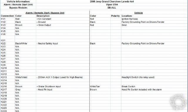

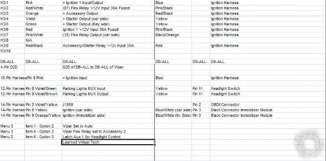

One last time before i give up on this car. Can you please look over the connections and let me know if it looks ok? I'm starting to think that i messed up somewhere since i saw the an exact same car running the same Viper 5704 with the same DB-ALL module. Thank you!

Strange problem. First let me say I don't use DB-ALL's ( prefer Fortin and iDatalink ) and I always wire
things up in W2W mode.
Looking over your wiring, everything looks correct, including the Viper programming.
Before you give up, why not try a few things.
First, while it shouldn't matter, move the DB-ALL's J1850 wire to Yellow/Violet ( or Yellow/Black ) wire at
Pin 5 of the Black SKIM transponder connector ( where you interrupted the Blue/White Ignition wire ).
As a final attempt...
I know it's a bit of a pain, but convert over to the W2W install mode. Ensure all wire connections are soldered.
