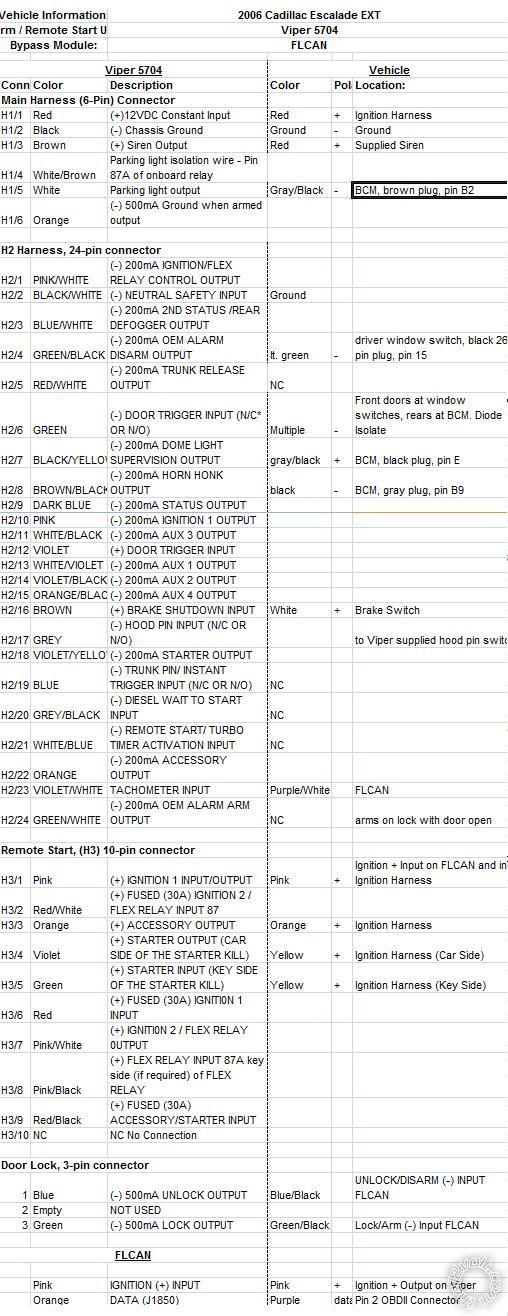

Ok, so I started setting up a wiring diagram for W2W and I haven't gotten very far. I'm struggling to understand what to do with a lot of the wires. Here's my vehicles wiring guide: http://www.sendspace.com/file/qsnfr1
Here is what I have so far, I am missing a lot. I think I am headed in the right direction. The hardest part I'm struggling with is the ignition/ignition 2 and the second accessory on my vehicle. Thank you for any help, it is greatly appreciated.

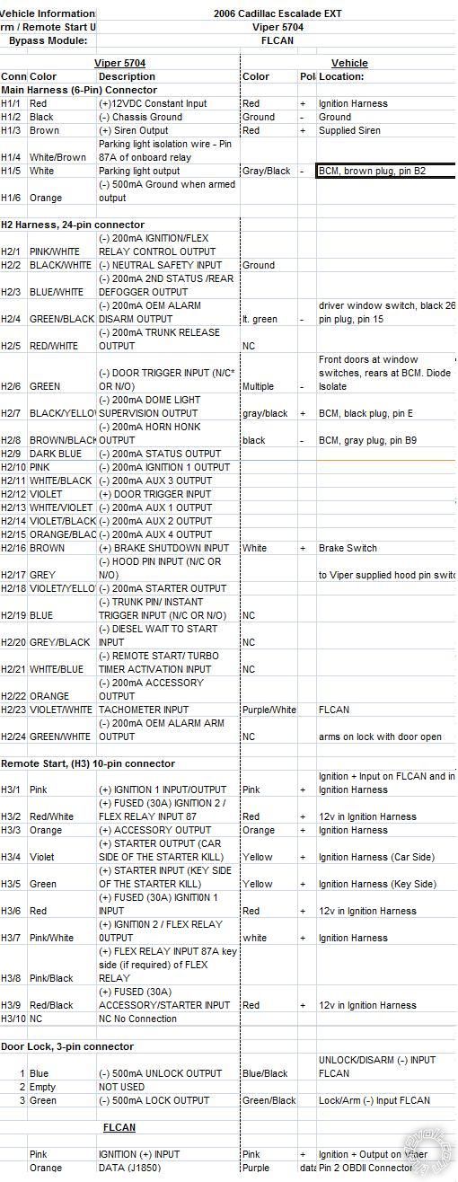

I think I figured out some more wires on the remote start harness.

Looking good! Very through job. Here are some thoughts you probably have covered but did not
mention.
The FLCAN will be flashed with the FLC-AL(DL)-GM1 firmware. For W2W mode you will set the FLCAN's
Installation Mode to Standard ( 2 blinks ) and lock it in prior to vehicle programming. Follow the #6619
install guide, Type 3 wiring diagram. Make all of the necessary connections between the two modules,
Viper and FLCAN shown ( either dashed Yellow or solid Black lines ).
A few notes:
The FLCAN will provide only the front doors' status. The rear doors must be manually added in to the
Viper.
The FLCAN will not do the rear trunk / hatch release.
As noted in the 2003 Yukon Pictorial, the Tach signal provided by the bypass might be problematic. Use
it and set the Viper to Tach Mode but be prepared to switch to the actual Instrument Cluster Tach wire if
issues arise. The 2003 Yukon Pictorial uses the iDatalink ADS DL module with the DL GM1 firmware, so
it is very similar to your installation. https://www.the12volt.com/installbay/forum_posts.asp~TID~133000~PN~1
Notes on your ( very nice ) wire list :
1. Set Viper Parking Light jumper/fuse to the (-) position.
2. For H2/6 Door Trigger Input, you can use the FLCAN's Yellow/Black Door Status output and then add in the
rear doors, diode isolated, as noted.
3. Think you will find either 2 Red or one Red and one RED / White +12V constant wires at the ignition harness
to use and split-up the Vipers load.
4. Not sure if you really need the Dome Light Supervision connection.
5. Going in W2W Mode you must connect the Viper H2/9 Dark Blue (-) Status Output wire to the FLCAN
Blue/White GWR wire. The Red and Black wires at that FLCAN 4 Pin connector go to +12V and chassis ground.
6. There is a Brown Accessory2 ignition wire. Not sure if it is necessary for a standard install. You might
need it if you plan on doing window-roll-up control, etc. Powering this wire would require an extra 30/40 Amp
relay and 20 Amp fuse. Use the Vipers H2/22 Orange (-) 200mA Accessory Output wire to control the relay.

Thank you. I made the change to the door trigger, removed the domelight supervision, added the dark blue(-) status output, and also the red and black on the 4 pin of the FLCAN.
Can I use the Brown Disarm Only input of the FLCAN for the GREEN/ Black OEM Disarm output of viper?
And the GREEN/ Black Lock/Arm input of the FLCAN for the GREEN / WHITE oem alarm arm output of the viper?

Yes on the Viper Disarm to FLCAN Disarm. Sorry I missed that and going into the door in a pain. Only connect the Viper lock wires to the FLCAN lock/alarm wires. No need to confuse the FLCAN with extra pulses. When the Viper locks the FLCAN will lock & arm the Escalade. Same for unlock, it will disarm and unlock. The separate Disarm is used prior to a remote start to disarm the Escalade.
No need for the H1/6 wire unless you want to do more than a basic install. ( window roll-up, etc )
As you can see, going W2W makes everything logical and easy to understand.

I've got everything all bench prepped and ready to install this weekend. I just have one more question on the door triggers.
Does the Yellow/Black wire need a diode on it as well as the 2 wires for the rear doors? Or is the Yellow/black wire ok, and just need diodes on the rear door wires?
It probably wouldn't hurt anything by having one on all 3, I just want to make sure. Thanks
Platinum - Posts: 7,827
Posted: October 03, 2013 at 9:44 PM / IP Logged
The diodes prevent feed back. Typically, they are used to isolate each door trigger wire from the others.
Some vehicles actually have a display on the dash that shows which door is open. Without diode isolation,
any open door will make the display show all four doors open... While using a diode on the FLCAN's Door
Status Output wire won't hurt, it isn't absolutely necessary.
