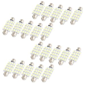

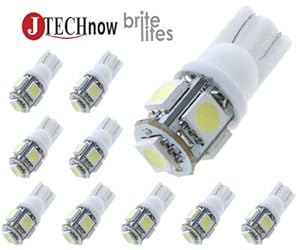

I have been getting great deals on LEDs from Amazon.... I got 20 Festoon panel lights, for under $10.00, each panel has 12 LEDs. ARe they CHEAPLY MADE? You bet, but they're under a lens... I also got TEN 168 type LEDs for under $4.00 + shipping, they all work.

Actually, each 562 panel has 16 LEDS, forgot, four rows of four LEDs.
Each 194 has five LEDs, one forward, one on each side.
converting tail lights -- posted image.
I got plenty of them... Did my whole car with LEDs...
