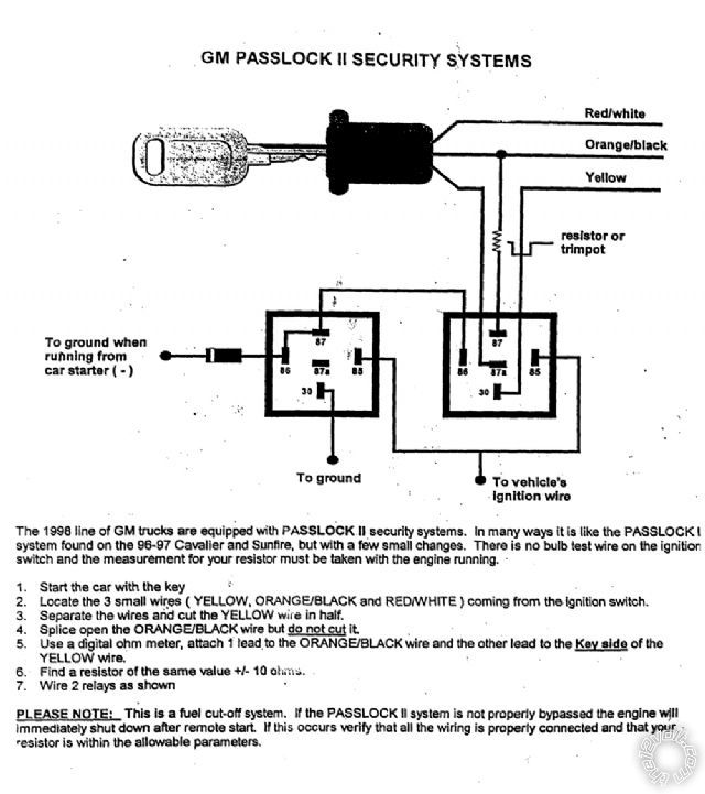

Funny thing, I came to the website to ask a passlock 2 question as well.
Here is the diagram, which can be found in the downloads section.
My question is, what is the purpose of the 1st relay on the left? Seems like all it's doing is amplifying the ground to the 86 of the 2nd relay (which by my observation is useless)...
Can I do without the 1st relay without any ill effects?

So the Relay on the Left has 2 grounds?? And does this setup bypass the Passlock all the time or just for remote starting? And does it matter if you get the wires from the ignition or the BCM?

As for one relay or two, (-) Status Output ( GWR ) or  (-) Starter relay control...  There are many ways to bypass
the Passlock2 system.  Take a look at DEI Tech Tip 1048 and this diagram from Audiovox :
http://documents.audiovox.com/700054.pdf

Also if I wanted to do the first relay diagram in the DEI Tech tip 1048, my remote start/alarm doesn't have a wire output labeled "Status (-)", would I use "Armed Output (-)" or leave pin 85 of the relay with no connection?

the first relay operates upon remote starting. it stays latched throughout the run cycle of the remote start as well as when the ignition key is operated to take over operation of the vehicle.
this is probably to keep the vehicle from detecting an intermittent in the passlock II.

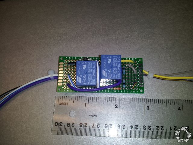

yellow_cake
Copper - Posts: 178
Joined: December 01, 2011
Posted: November 14, 2013 at 1:37 AM / IP Logged
Thanks Ween,
You are right about the latching part, I couldn't figure that out till you told me.
Just a photo of my diy setup. It took me about 45mins, not worth the time if you do it for a living.
My resistors are less than 1% off from the measurement of the ignition switch Passlock 2 Manual Bypass -- posted image.!
Platinum - Posts: 7,828
Posted: November 14, 2013 at 4:03 AM / IP Logged
Yellow_Cake, nice job!  Passlock 2 Manual Bypass -- posted image.   Another good use for those 10 Amp mini-relays.
