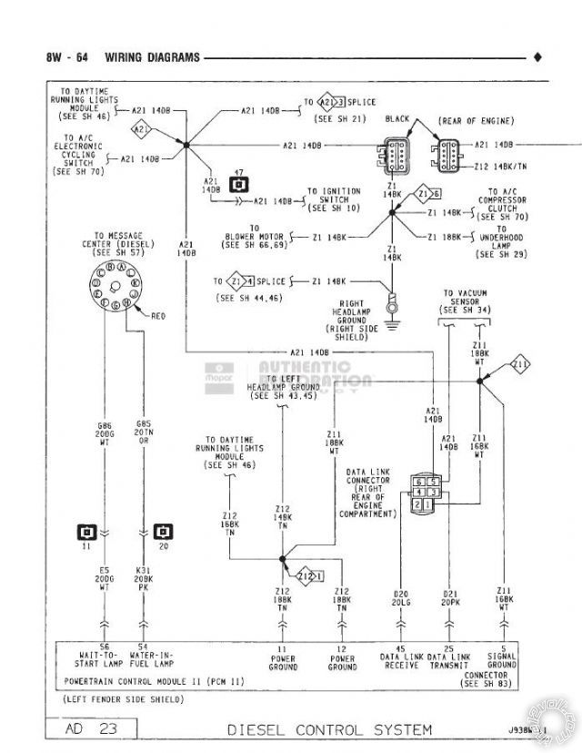

  Yes, if a harness has no needed wires, leave it off.  Unused wires in a harness can be cut to 2" and bundled neatly or even de-pinned / removed.  Keeping the install neat is important. here is the schematic of the wait to start circuit. I'm not sure if its positive or negative?
