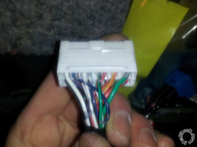

As triniforever states, the 3 wires are all coming from the driver's door switch.
There is only one GREEN/ red (lock) and GREEN/ black (unlock) colored wires. However there are more than one blue/black colored wires so you need to test each to find the lock detection wire.
Test using the key in the door lock cylinder, make sure the door switch module is plugged as well.
The lock wire will show ground when the key is turned to the lock position; unlock wire will show ground in the unlock position; the lock detection wire will also show ground in the unlock position if I'm not mistaken.
It doesn't matter which side of the relay you attach the 2nd diode to for the lock detection wire. That relay will only interrupt that wire during locking, so it will get the pulse from the unlock no matter which side you connect to.
IS300 driver's door switch harness connector:
2001 lexus is300 viper 5704v -- posted image.

I got them hooked up and works great and to figure out which blue black wire to use I looked at my door unlock and lock wires and they have two silver dots on them from factory so I looked at the blue black wires and one of them had two silver dots and that was it.
