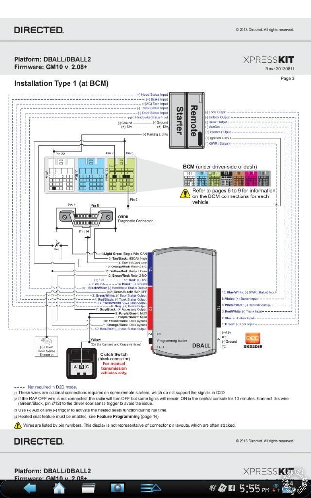

I havent started but i did purchase viper 5704 with dball module i have all needed diagrams and i need help understanding the dball diagram on a few connections

yea my bad on the dball diagram harness 14 pins 10,11 & 12 is where my confusion is.2011 camaro alarm -- posted image.

No not remote start i did 1 on my 88 monte carlo ..... Damn i miss that car I appreciate the help im just confused on the 3 wire from harness 14 wire 10 ORANGE / Red where i have to cut then do ??

I cant edit my last post but i didnt mean to put 3 wire just wire 10 ORANGE / red from harness 14

For instance on pin #2 that wire has to be cut and the ORANGE / Red wire from the DBALL goes to the cut side away from the BCM and the Yellow/Red wire from the DBALL has to be connected to the plug side of the of the wire from the BCM.

OOOOh OOOk i got you man thanks big time
