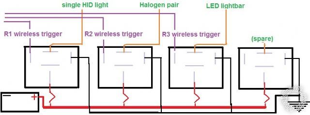

I've sketched out what I think I need.
power distribution -- posted image.
In the grand scheme of things, I believe this is what I should have done in the first place...rather than mounting and wiring each relay separately.
And I am also now thinking that it makes more sense to use a 5- or 6- terminal FUSE HOLDER/terminal block in the box, because it will:
a) reduce complexity
b) reduce wiring outside the box
c) be easier to find than a one-becomes-many terminal block...which would still require separate fuses anyway

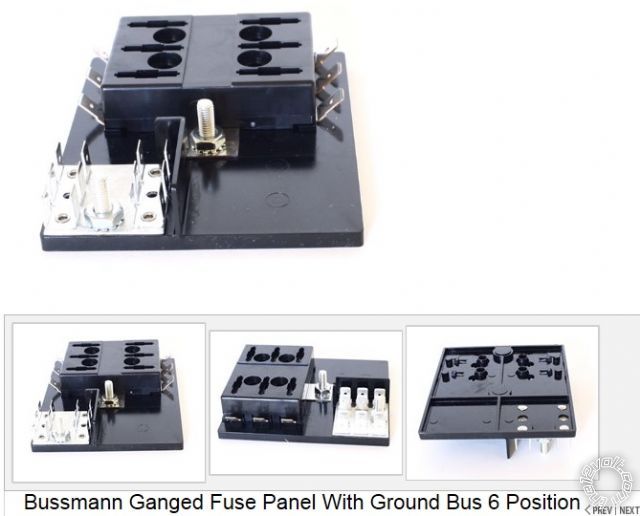

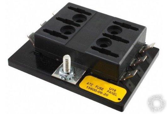

Holy cow - this is getting exciting! I've found almost exactly what I'm looking for:
Ideally I only want FOUR terminals (which is already one more than I expect to need) but I can't find any one-in-many-out with fewer than six terminals.
Anyway - I like the first flat black one the best, because it also offers a ground bus...which is going to further simplify and condense my wiring.
My next choice would be the second flat black one. Both look like an easier fit inside a die-cast box.
And my third choice would be...well...the third one.
Is there any advantage (or disadvantage) to any one of these options? Any features or possible problems that are not obvious from the photos? I've never worked with anything like this...but it certainly looks appealing!!
A big thanks to 'Ween' for steering me in this direction!!
