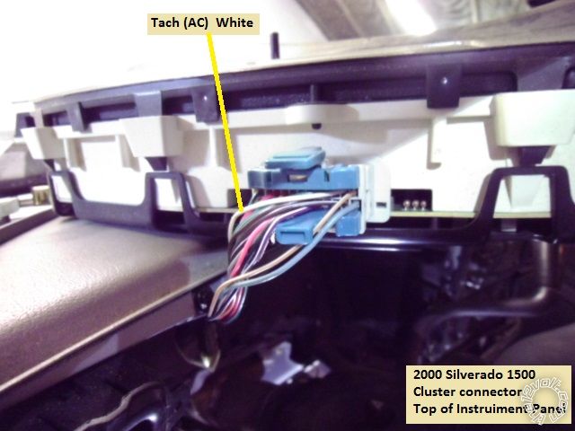

No, I actually prefer the W2W hard-wire method myself ( as seen in the Pictorial ).  As noted at the end of the Pictorial, the GM1 firmware will occasionally have problems supplying a tach signal, so going directly to a vehicle tach source is a good idea.  On that vehicle, I think I would pull the instrument cluster and catch the tach signal there.  The bezel trim just pulls off and there are four 7mm screws to remove.  The instrument panel harness has plenty of slack, so you can just leave it connected while soldering on the wire.  It is probably the only White in the connector and has a nice strong signal.  Here is a photo of a similar vehicle :
2004 gmc denali ads alsl gm1 -- posted image.
More info from ReadyRemote :
Tachometer    White (ac)        @ instrument cluster, gray 24 pin plug, pin A5

Well, unfortunately, that didn't work either. Looks like there's a strong tach signal coming through, but the RS just isn't responding to it.
