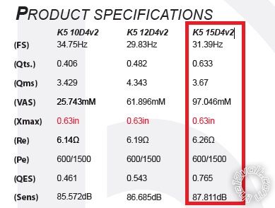

I was just looking for any feedback from people who have used or heard of these subs
quantum subs -- posted image.

To get the best performance out of that sub (circled in red) you'll need a huge enclosure. Sealed comes in at 374.2 liters (13.2 cuft) and vented should be 422.5 liters (14.9 cuft) ported at ~20Hz.
