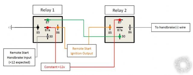

You can use two 5 pin relays to do this. This circuit will always send a +12v to the remote start, but when the remote start is activated, it will check the handbrake. If the handbrake is not set, it disconnects the +12v source to the remote start. Here's the pinout:
First Relay:
Pin 85 - Ground
Pin 86 - Ignition output from remote starter
Pin 87a - Constant +12v
Pin 87 - to pin 30 on relay 2
Pin 30 - to handbrake wire from remote starter (+12v)
Second Relay:
Pin 85 - from car's handbrake wire
Pin 87a - not used
Pin 87 - Constant +12v
Pin 30 - to relay 1 pin 30
handbrake signal for remote start -- posted image.

thankyou bud..what type of 5pin relay do.i need?
