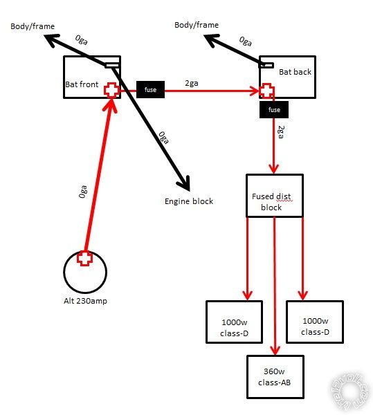

Will this work out ok, or do I HAVE TO replace my 2ga run from front to back with 0ga?
second battery set up -- posted image.

I'll let others comment about the wire gauges (noting that your amps may also consume 230A or more; then add back battery recharge current).
But to have omitted the 2nd fuse between the 2 batteries - one at each end.
And unless you intend to open the connection between the batteries when not in use, I'd suggest an automated battery isolator.
If you have a charge light, for the best and cheapest google uibi or 'uibi oldspark'.

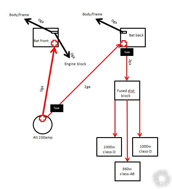

SHould I run the second battery straight to the alternator? I mean if they share the post on the alternator, isn't that the same?

No I'm not saying that (and as you say, they are the same).
I'm saying:
- you need TWO fuses between the batteries - one near each battery, &
- you should not leave batteries permanently paralleled (that's one reason automatic battery isolators are used).

I'm not getting into the power side at all other than pointing out your max possible current down the rear line - ie, full output amp draw plus the 2nd battery recharge current.
Many have your load with smaller alternators - after all, if your alt isn't at adequate RPM then it won't output its full amperage.
How big an alternator depends on (1) if dipping to (say) 12.7V or lower is ok during surges or low RPM, and (2) if the alternator is required to replace the used battery charge over a normal driving cycle (as opposed to external charging).
I am merely emphasising your missing fuse, and the desire for isolation when not in use.
Isolation during cranking is probably not an issue since your inter-battery link is likely to be sized appropriately. (And sharing the cranking extends battery life assuming the 2nd battery is not small.)   Hence maybe an IGN controlled or amp-remote isolator if not a UIBI.
The isolator has to be rated higher than the fuses you are using.
But you just need a suitable isolator and have that run the actual isolator relay. (IE you don't need a 200A or 400A isolator; a 2A or 30A etc isolator should do and that can drive a 200A or 400A relay/contactor.)
