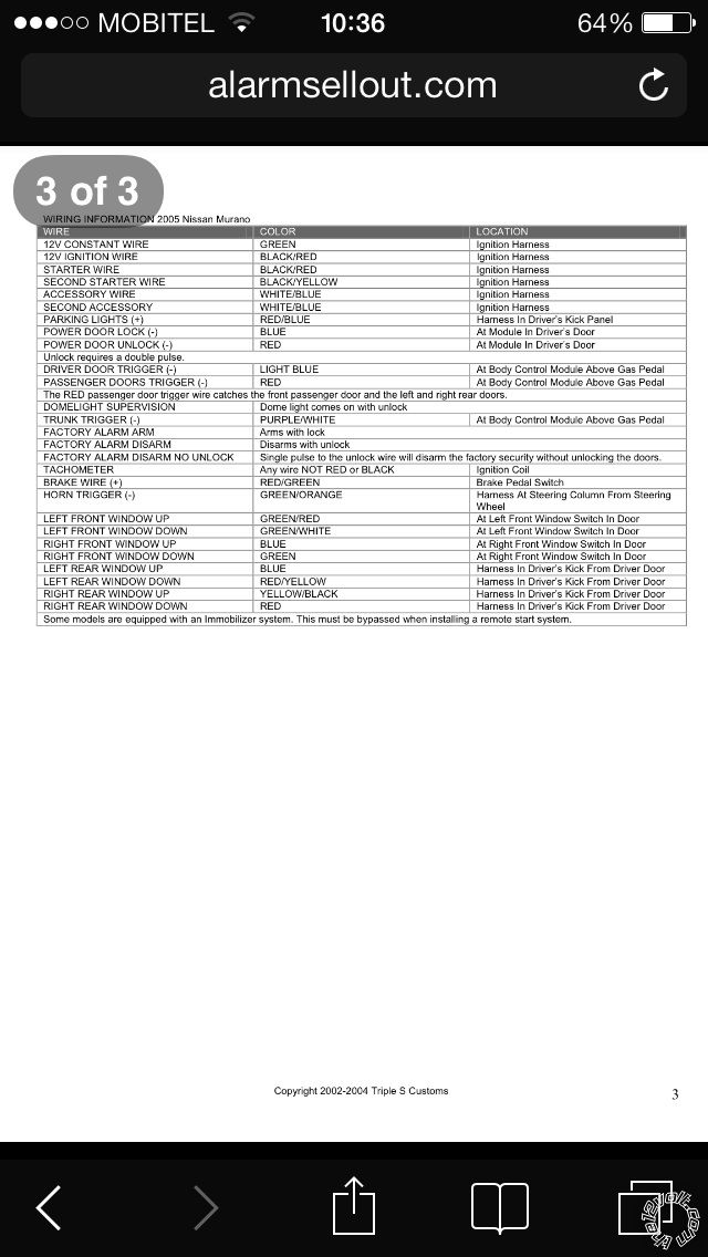

Hi,
Car is 06 year ;)
I cant find security light wire, I dont have 40pin
connector on BCM like install guide is showing.
Wich wire goes where on ignition Harnes?
where goes 200ma status output,
starter output...
In my remote when remote start is press
it says Remote start is not available.
And there is no modul in drivers door for lock unlock
Regards

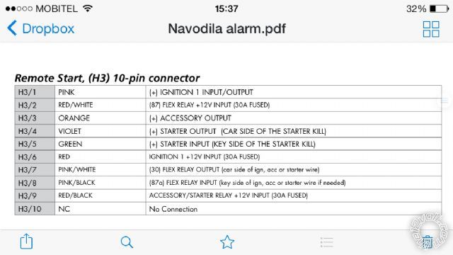

Hi,
If some one would know please write answer.
first is remote start diagram and second may car
diagram.
I have connected as I best know, but does not work.
alsso flash logic flcan will do door lock/unlock-car has no alarm.....
I dont need to connect wires from alarm to my car if flcan has that function?
python 594 and flcan in murano 07 -- posted image. python 594 and flcan in murano 07 -- posted image.
Thank you
