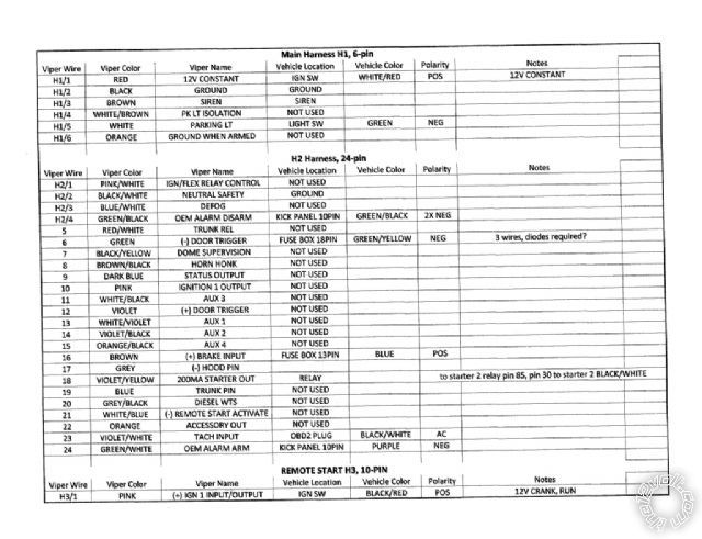

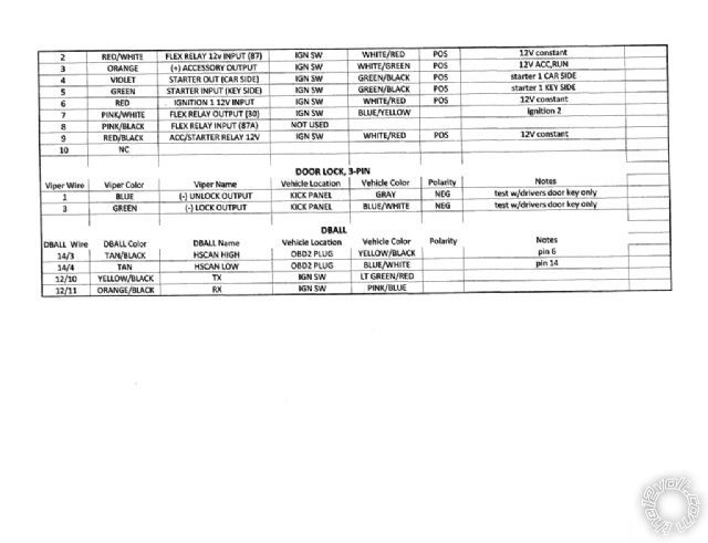

If someone can double check my connections I would appreciate it.
viper 5706v,dball2, 2010 tacoma -- posted image.viper 5706v,dball2, 2010 tacoma -- posted image.

The DBALL will eliminate all those wires. Hook up the HSCAN wires and the RX/TX wires to the immobilizer and you're good to go.
All these power, status, triggers, etc. are communicated over the HSCAN. It's like a network.
Just make sure the DBALL is updated to the latest firmware via the XKLoader2. Read the entire manual for the DBALL and you should be good to go!

Could you be more specific about which wires I can leave off the alarm? It looks like it can do a lot, but for my vehicle it will only send brake, handbrake, and ignition status to the alarm/rs.
