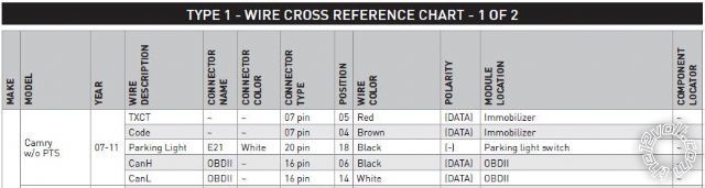

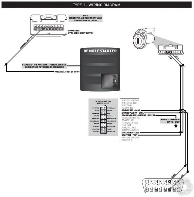

Starting with the BLADE-AL installation manual, there are about 5 wiring connections from the BLADE-AL wiring harness. I've attached the wiring diagram from the BLADE-AL manual:
2011 camry with cm6200 and blade al -- posted image.
The connection information for the BLADE-AL wiring harness is stated as follows in the BLADE-AL manual. The information is listed in the order of: "BLADE PIN#-BLADE WIRE COLOR-ITEM-FACTORY CONNECTOR INFO-FACTORY PIN POSITION-FACTORY WIRE COLOR-LOCATION".
Pin 1 – Gray/Red – TXCT – 7 Pin Connector – Pin 5 – Red – Immobilizer (Ignition switch per diagram)
Pin 2 – GREEN/ Red – CODE – 7 Pin Connector – Pin 4 – Brown – Immobilizer (Ignition switch per diagram)
Pin 5 – ORANGE / Black – GROUND INPUT (-) – Only if I don't use a Hood Pin
Pin 6 – BROWN / Red – CANH – 16 Pin Connector – Pin 6 – Black – OBDII
Pin 16 – BROWN / Yellow – CANL – 16 Pin Connector – Pin 14 – White – OBDII
Following is a picture of the wiring callout from the BLADE-AL manual.

OK.  I like your through preliminary work on this project.  It truely is "all in the planning".
The CM6200 and Blade AL is a great combination.  Very compact and reliable.   The Blade AL needs to flashed with the DL TL1
firmware while inserted into the CM6200.  This requires the ADS USB cable and access to the Flash section of their WEB site.
When you do this, it will also update the firmware on the CM6200 ( if necessary ) and allow you to set the CM6200 programming
options.
For vehicle wiring, here are some sources :
Here is a link to Bulldog Security :  http://www.bulldogsecurity.com/bdnew/vehiclewiringdiagrams.asp
Here is a link to Ready Remote :  http://www.readyremote.com/main.asp
Here is a link to AudioVox :  http://techservices.audiovox.com/AccessRequest.aspx    Sign-up & info is free.
Your next step is to download all the wire guide info you can from as many sources as possible.  Compare them as there
probably will be differences.  Consolidate everything on a cheat sheet.  You will use this as your guide during the install.
The Blade w/TL1 will handle a bunch of things for you.  They are listed on Page 2 of the install guide.  The Type 1 Wiring Diagram
gives you most of the rest of the wiring.  You car has a few exceptions in it.

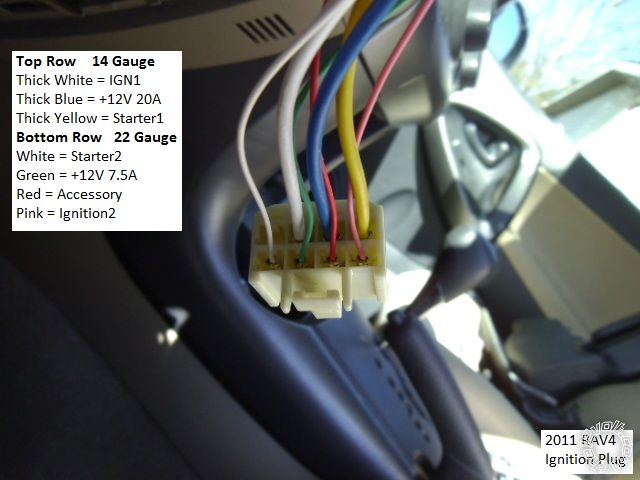

Pin 1 – White – (+) 12V Accessory –         white  +  ignition switch, white 8 pin plug, pin 2
Pin 2 – Yellow – (+) 12V Starter – blue  +  ignition switch, white 8 pin plug, pin 7
Pin 3 – Green #1 – 12V Ignition – yellow  +  ignition switch, white 8 pin plug, pin 6
Pin 4 – Black – Ground (-) –          chassis ground
Pin 5 – Red #1 – 12V Constant – black (30A)  +    ignition switch, white 8 pin plug, pin 5
Pin 5 – Red #2 – 12V Constant – black (30A)  +    ignition switch, white 8 pin plug, pin 5

Here is a photo of the Headlight connector in the steering column of a 2011 RAV4 :
It is a White 20 Pin connector but the Parking Light wire at Pin 18 is White, your Camry's wire will be Black.
If you want photos of these wires, Fortin has a optional service called WireColor that should provide pictures of most
of these wires.  They change a $5 per vehicle fee.  Here is a link :  http://wirecolor.com/en/

If the 2011 Camry is similar to the 2011 RAV4 pictured below, there might be a few 7.5 Amp wires in the harness.
