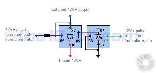

Your last diagram will create a latch, but you only need one relay to create a latch with a postive pulse and a second relay to break the latch with either a positive or negative pulse. I'll draw up a diagram today and post it here when I finish.
latching relay 12v trigger -- posted image. the12volt • Support the12volt.com
the12volt
Administrator - Posts: 3,957
Joined: March 07, 2002
Posted: February 12, 2014 at 12:23 PM / IP Logged

i have a momentary push button switch installed (hidden where only i know where it is) that when the factory alarm is going off, i can disarm it from the remote but the DEI sirens are still going off because it is still getting 12 volt so i hit the switch to break that feed from the battery. when i disarm with the remote, that factory wire does not send another 12volt pulse. it just shuts the alarm off. now unless i am missing something somewhere, i don't think what i want to accomplish can be down without a switch to break ground or 12v somewhere.

You could use the door unlock motor leg to kill the latch when you disarm it.
Unlock Motor      red      driver kick, white 56 pin plug, pin 11

the12volt
Posted: February 13, 2014 at 12:21 PM / IP Logged
