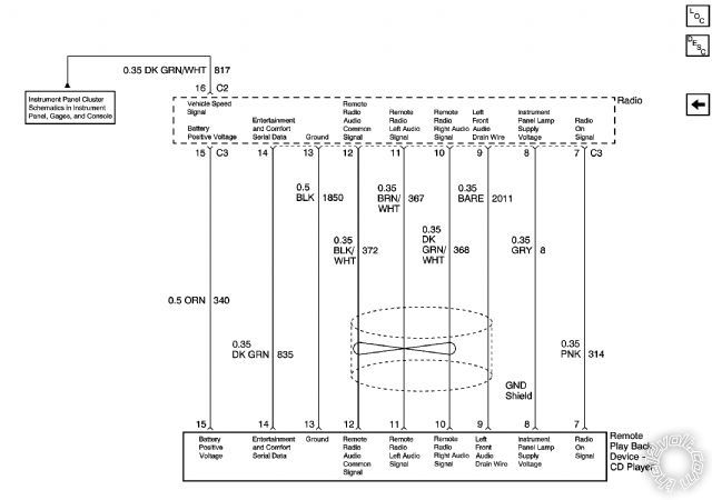

I think I'm posting in the right spot. I removed my radio from my tahoe and noticed that there is now no power to the cassette player harness. I have the wire harness kit for the aftermarket install for aftermarket radio is there two wires that i connect on the radio harness to get power back to the cassette harness. Reason asking is i tapped into the cassette harness to power other things.

You will have to figure out which wire is the power one, and connect it to the yellow or the red of the radio harness. Is it a switched power source or constant? If switched, connect it to the red wire. If constant, connect to the yellow wire.

does this help? its the gm schematic for a radio with an external cd player. 2001_tahoe_up_level.gif
