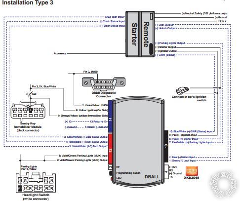

smokeman1 wrote:
Could you list your connections from the car...5501...DB-ALL
Currently in D2D Configuration
Here are the connections:
On the DB-ALL
viper 5501 db all issues -- posted image.
#10 Harness
#3 Pink (ignition Input) to H3/1 PINK (+) IGNITION 1 INPUT/OUTPUT
#12 Harness
#8/#9 Wired as shown in diagram
#14 Harness
#2,#8,#9 Wired as Shown in Diagram

I am thinking Thast I definitely have my Accessory 2 wiring messed up regarding the HVAC controls.
Does the H3/6 Pink/White need to changed to Accessory 2 in the Menu?
Now here are the 2 things that have me concerned. Since the DBALL was used with the AVITAL 4103 and everything was working.
1. I am very concerned that all of the DASH Warning LIGHTS are lit up when running via remote start using the Viper. (The warning lights shut off when i put in the key and take over.) Whould I be worried about this? thE aVITAL NEVER HAD ANY OF THESE LIGHTS LIT UP??????
2. When I was using the AVITAL the parking lights worked as they should via D2D and the DBALL. Now with this viper, the parking lights flash as they should but they do not stay on constant. I used a Bitwriter to ensure they were set to constant and I even changed the setting to Pulse. Just not sure why they would work via D2D on the Avital and not the Viper?????

On the DB-ALL #10 harness, is my connection for the #3 Pink (ignition Input) to H3/1 PINK (+) IGNITION 1 INPUT/OUTPUT connected wrong? Would this connection cause the warning lights on remote start up?

H3/2, H3/5, H3/8 all to constant 12 volt power.
H3/3 to Acc 1 Jeep RED / Black (+) Test with DMM
H3/6 SET AS Accessory in Menu, to Jeep Acc 2 BLACK/ Orange (+)Test with DMM
H3/1 to DB-ALL Pin 9 of 10 pin connector, and Dark Blue (+) of Jeep Ignition 1. Test with DMM (Ignition)
Thank You!!!!
Wired it up as you suggested above and all is good.
The parking lights still will not come on "constant" with remote start although they are controlled by the DBALL. I can live with out this though...
The pressing question that I have is, when I unlock the jeep, only the drivers door unlocks??? When I had the Avital installed, all doors unlocked??? When using the the factory fobs, all the doors unlock as well......

By default, the DBALL sets the driver's door to priority, meaning just that door will unlock first, if you press unlock again, the other doors should unlock.
This is feature #2 in the installation manual. When set to All, all the doors will unlock at the same time.
For the parking lights, verify pin 8 and pin 9 on the DBALL Red harness. They should be connected together at the yellow wire pin 11 on the headlight switch. If you soldered the connection, verify the connection with a multimeter.
Thanks! I went in and changed feature 2 to all. Pin 8/9 are good on the red harness. I think the parking light issue is based on the Viper 5501. I just removed an avital 4103L one way r/s system for this viper. On the Avital, everything worked. I was using the same dball with the same programming. On the avital, the parking lights were constant on with remote start and the doors all unlocked with one click of the remote even though the dball was set for priority...... Also, all doors unlocked when the drivers door was opened, where as the viper would not and I went in to feature programming and set it to unlock all doors upon Turing off the ignition.
