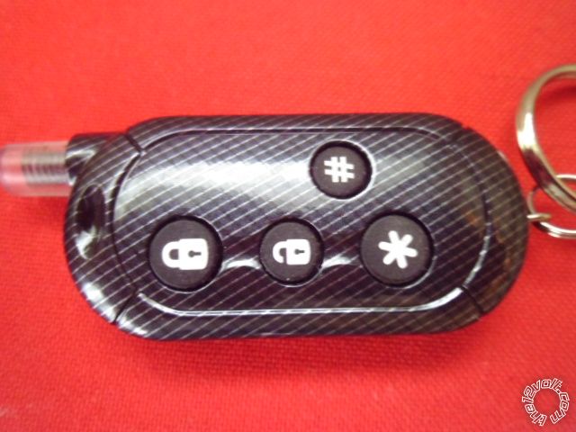

anyone reconize the make of this system?
chev104275
Gold - Posts: 1,436
Joined: November 26, 2007
Posted: April 02, 2014 at 7:04 AM / IP Logged
I just bought a truck with this system already installed in it. The brain had no markings what so ever neither does the remote. The system works fine but i only have one remote and would like to get another one. Here is a pic of the remote. Anyone reconize it ?
Chris Luongo
Platinum - Posts: 3,746
Joined: May 21, 2002
Posted: April 02, 2014 at 7:16 AM / IP Logged
That looks like an Ultra Start remote from a few years ago.
eBay search for "ultra start remote" and dig through the results; there are a couple there.
Or go to www.ultrastarters.com and see if they can help you---you'll need to find instructions to program the remote to your system as well.

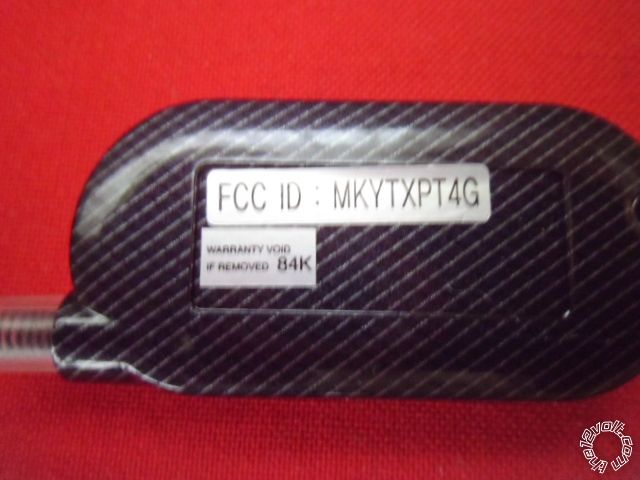

Chris is correct.  It looks like an Ultra Start G-11 remote.  Typically the brain controller has a white label on the bottom side with the Model number.  The good news is that the frequency is standard throughout their line.  It is a one-way, AM, four button remote and any similar remote will work.  I have used the U1250, U1270, U1272, U1280 system remotes interchangeably without problems.
Pairing remotes is simple and common for their R/S's, too.  This is detailed in the Install Guides.

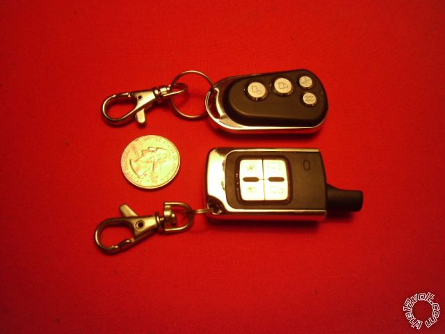

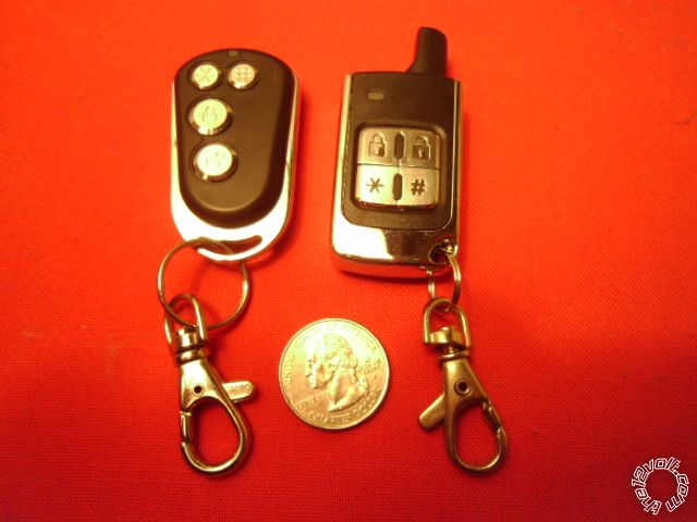

Here are some other interchangeable style remotes :
