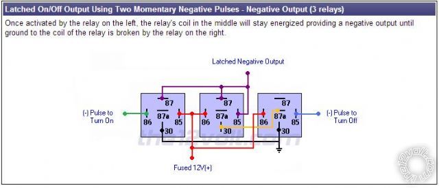

Hey Thanks for your input on this...I found this relay diagram what do you think about this setup....
weird intermittent start problem 2011 camaro -- posted image.
i won't be using the OEM remote at all just the RS remote...so i can you the negative unlock pulse of the system to turn on the relay which would output to the GWR wire of the FLCAN...and use the lock pulse to turn off the relay??? or maybe even use the GWR signal from my RS to turn off the relay unit while also activating the FLCAN.
