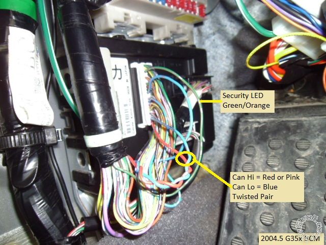

Not really enough info to help you.  The early G35's ( 2003 &2004 ) had the older style BCM. The newer G35's ( 2005 & 2006 for the sedan and 2005 - 2007 for the coupe ) had the newer style BCM.  Would help to know the year and model.
Aside from that, did you get the DB-ALL2 flashed with the correct ( 402.NISS01 v1.04 ) firmware?
Here is a link to the DB-ALL2 w/NISS01 firmware install guide :  http://www.xpresskit.com/DocumentDownload.aspx?documentid=9211&productid=553&firmwareid=5372  Fairly easy car to do.  The BCM is in the driver kick panel.
Here is a photo of the BCM from a 2004.5 G35x with the newer style BCM :
g35, viper 4105vb and dball2 -- posted image.
