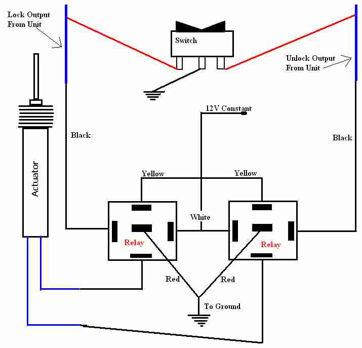

What I meant was, I already have a centralized door lock system. The problem is that I have to grab the lock lever over my left shoulder with my right hand when unlocking the door. I want to wire a push button in my existing Relay system (2 pieces) and place it somewhere convenient to reach. My friend's car uses a simple SPST normally open push button and two SPDT relays. I don't know how the technician did it but I really like the feature.
My other option is to use an SPDT rocker switch with a rest postion (ON-OFF-ON) which is alot easier to rewire.

I never had power door locks in my car...so I installed 2 actuators. But I still had no button to open the locks, so I installed a switch like you're talking about...it's called a non-locking rocker switch (on-off-on), and it rests in the middle.
Since I had added two actuators, I had added two relays to make them work. I believe I just hooked up the switch to the relays to lock and unlock them.

Got any diagrams for this?

Here's the diagram that I had when I did this. You'll see that I had to add 2 relays, and then I had added 2 actuators as well. All I did was attach one end of the switch to the lock output from the unit, and the other end of the switch to the unlock output of the unit....and the middle of the switch is attached to ground. So...depending on which way you press the switch, it will give ground to either lock or unlock.
Push Button Car Door unlock/lock -- posted image.
Good luck...write back if you have more questions.

Thank you ! I have a Clifford IG-700IQ with smart windows and the installer had to retrofit it with power door locks, with this I guess all I have to do is go to the relays and tap into them.

Yea, if you have a similar situation...then that's probably all you have to do. I guess he added actuators and 2 relays to your car? Then yea, you just have to tap into the wires shown above....and make sure you find a good spot for the switch.
