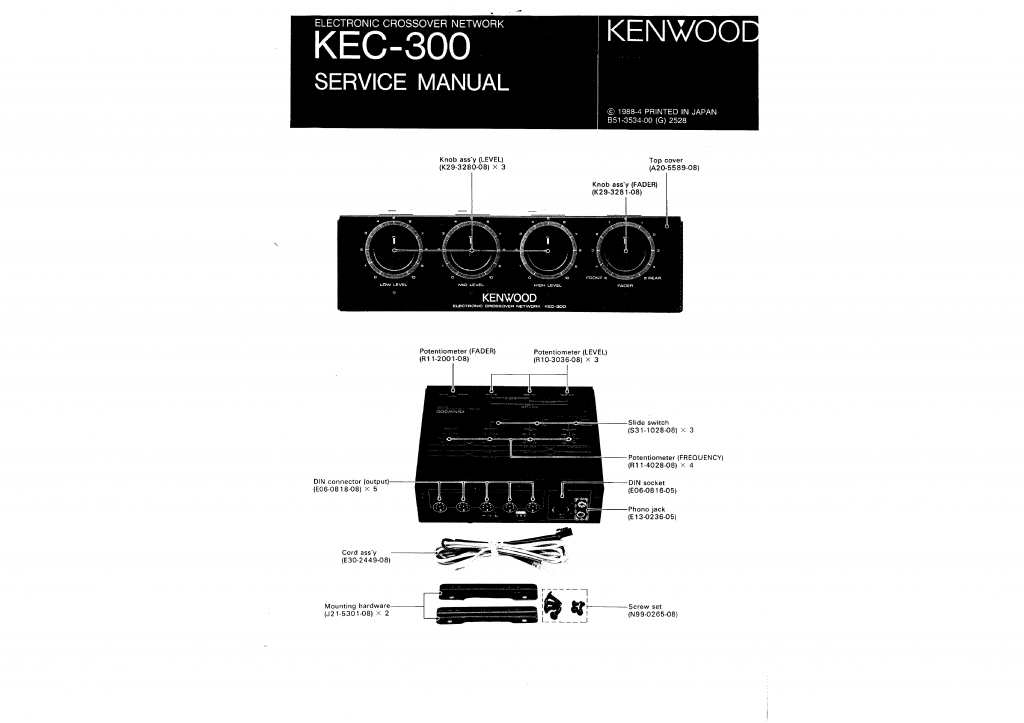

So long story short, my neighbor dropped off a huge box of audio supplies today. Went through it and found a Kenwood KEC-300 crossover. It has a standard RCA input, but five DIN plug outputs. Does anyone know where I can find these "DIN plugs"? I found a few pictures of it online, and what looks to be a part number.
kenwood kec 300 crossover din plugs? -- posted image.

I can tell you how to build one.
Take your right hand, looking at the palm of it with your fingers pointing back at your face, Pinky is remote turn on, next finger is open. Middle finger is shields of both left and right RCA cables next finger is left signal. Your thumb is right signal. That is how you make the 5 pin Male Din plug that will plug into the female outputs of the unit. The tips of your fingers are the pins of the din. Solder connections are to the back side of your hand.
It has been 20 years, I may have left and right backwards, but I am certain of the other connections.

that was a good xover in its day, I found it good as a small line driver and it improved noise problems, some times even iliminating ground loop noise. i am an idiot is right about making the din plugs, I did it all the time in the late 80's
