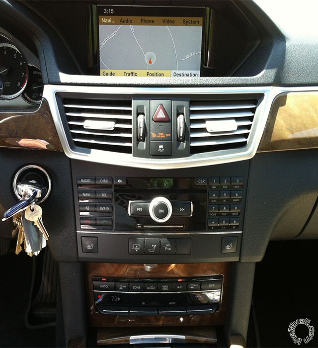

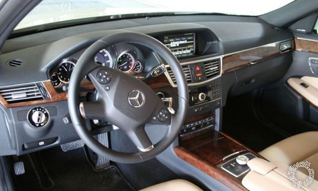

However, this new mercedes technology isn't just any old radio, it has the new COMAND station, exactly as shown in the pictures below.
Should I wire into the COMAND or should I wire into the rear/front speakers?

Is there a factory subwoofer in the rear deck of the car? If so, you will need to get signal from those wires. If it does not have a factory sub, you can catch signal from the front or rear speakers. If the rear speakers are in the rear deck, you should use the front speakers for input. There is probably a factory amplifier. You will not find any useable signal behind the radio.

Yea, if there's a factory sub then use that signal. If not, then tap the rear speakers with a good LOC and use the crossover in the subwoofer amp you'll be installing.
