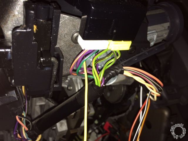

the yellow wire going to the harness is the MUX wire from the idata, going to the purple and brown wire

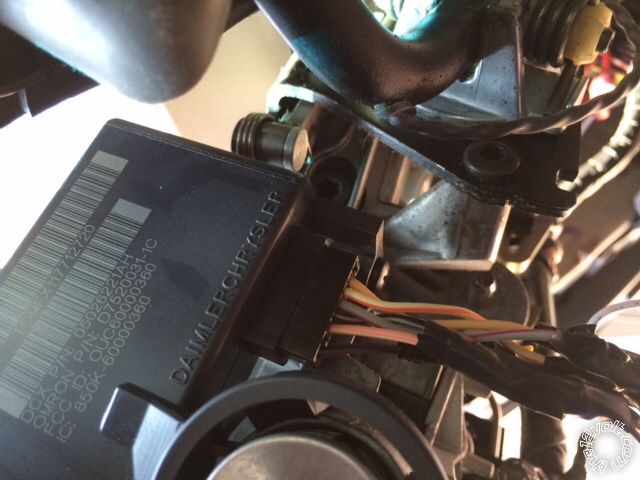

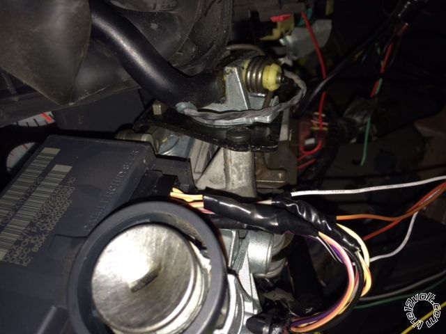

the CANL, CANH, 12V, and Ignition all connected at what appears to be the immobilizer.
And for the record the electrical tape is temporary, I used temporary connections to test everything before taking the time to solder.
