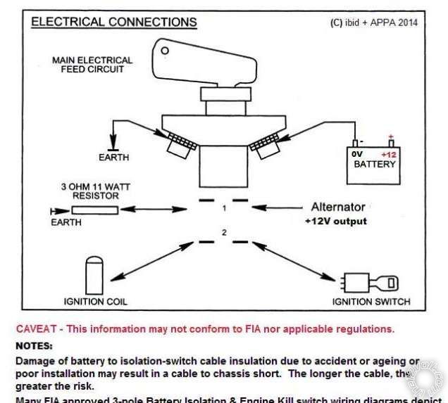

A few days ago I dropped in on a competitive mate who I hadn't seen for several years.
I asked if he was using - or if The Regulators - were prescribing multipole switches like the FIA approved Battery Isolator Switch when "engine kill" and "battery isolation" functions were combined.
What horrified me is that remote +12V isolation is still acceptable.
What amused me (with horror) was the other 2 things my mate said:
- various (complex?) arrangements use relays; &
- scrutineers don't care how the thing(s) work as long as when they flip the switch, the battery is isolated and the engine dies.
So yet again we can have a "safety feature" that kills you in the field but that's ok since it passed (static) tests.
Apologies, but I am simply amazed. We have devolved at least 30 years. What next - red EXIT signs in buildings (because that's logical? and ban laminated windscreens & airbag systems?
But I'll leave all that for the first victims to take action...
I was going to add that that is why I avoid Australian forums, however after seeing the wiring diagrams for the FIA approved switch (which all isolate the +12V batter terminal) I'm wondering if the rest of the world is turning stupid, or ignorant?
BTW - the IMO correct base diagram WRT heavy isolation wiring in the GND path ...battery disconnect switch in car - Page 3 -- posted image.
