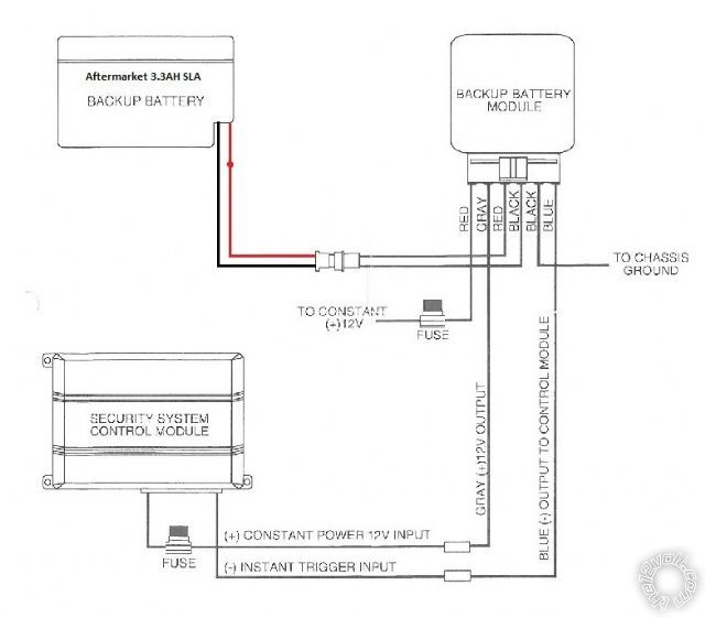

and this is how i installed my backup battery
the instant trigger is wired to 24pin aux/shut/trig harness
10 BLUE (-)TRUNK PIN/INSTANT TRIGGER INPUT (N/C OR N/O) --- Instant trigger
07 town & country - Page 2 -- posted image.
smokeman1
Platinum - Posts: 1,589
Joined: September 14, 2009
Posted: November 07, 2014 at 6:41 PM / IP Logged
RED / Black and Red to constant 12volt
Remove green from starter wire (yellow) and connect violet
Platinum - Posts: 7,828
Posted: November 07, 2014 at 6:46 PM / IP Logged
1 NC No Connection- -   -   – - – -     -- -       – - - –      -- -        Not used
2 RED / BLACK (+) FUSED 12V ACCESSORY/STARTER INPUT        +12V Constant
3 PINK/BLACK (+) FLEX RELAY INPUT 87A FLEX RELAY- - - -       Not used
4 PINK/WHITE (+) IGNITION 2 / FLEX RELAY OUTPUT- - - - - Not used
5 RED (+) FUSED 12V IGNITION 1 INPUT    -   -   - - - - - – - - – - - -  +12V Constant
6 GREEN (+) STARTER INPUT (KEY SIDE ) -      – - - –    – - YELLOW   @ IGNITION SWITCH   ( cut wire )
7 VIOLET (+) STARTER OUTPUT (CAR SIDE ) -       – - - – - - -         Yellow     @ IGNITION SWITCH   ( cut wire )
8 ORANGE (+) ACCESSORY OUTPUT -   -   - - - - - – - - – - - - - -      Not used
9 RED / WHITE (+) FUSED 12V IGNITION 2 / FLEX RELAY INPUT      Not used
10 PINK (+) IGNITION 1 INPUT/OUTPU -   -   - - - - - – - - – - - - - -      PINK/WHITE IGNITION SWITCH

thx for the reply, one more question the instant trigger from the back up battery, did i connect it correctly.
this is how i connected it
10 BLUE (-)TRUNK PIN/INSTANT TRIGGER INPUT (N/C OR N/O) --- Instant trigger Back Up Battery
