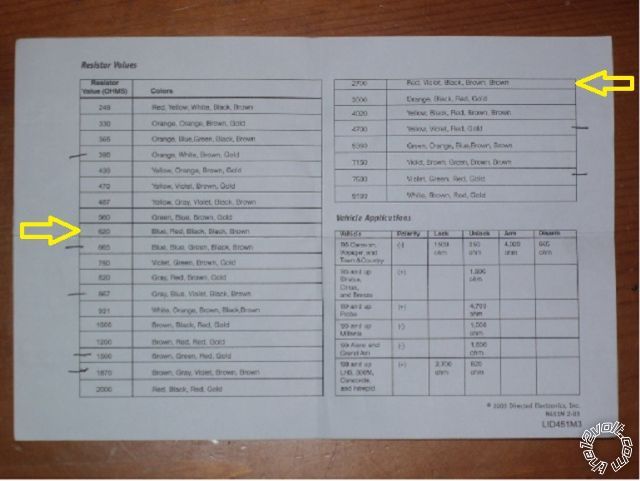

1 DEI 451M door lock kit. It's my understanding that this comes with resistors BUT does it have the ones I need a 600 ohm and 2700 ohm resistor? Should I buy a 600 ohm resistor and a 2700 ohm resistor?

It's actually a 620 ohm resistor for Unlock, but yes, the 451M lit includes both of the needed resistors.
Here is a photo of the listed resistor values included in the 451M kit :
Python 5303, 2001 Dodge Intrepid -- posted image.
