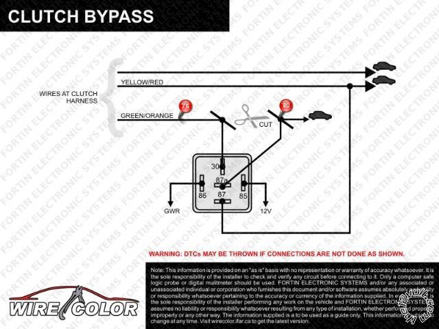

Bnluis
Silver - Posts: 578
Joined: December 24, 2002
Posted: December 09, 2014 at 3:51 PM / IP Logged Link to Post Post Reply Quote Bnluis
2012 wrangler clutch bypass -- posted image.
Luis

Posted: December 09, 2014 at 7:46 PM / IP Logged Link to Post Post Reply Quote shark mobile
Just did one and both luis and Ted are correct...without the relay it's going to throw codes ;). Follow the diagram and you'll be fine.
