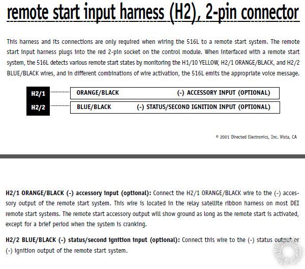

Hey guys, I have a question in regards to how I should wire two of my wires for my 516L voice add-on to my Viper 3203V Alarm/Remote Start system. Below is a screenshot of which wires go to which from my 516L to the alarm system.
516L Remote Start Input on Viper 3203V -- posted image.

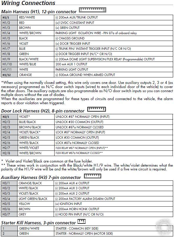

Then, this is the alarm diagram on the Viper.
However, the alarm diagram doesn't show the wires I need specifically to complete this. Does this mean I have to ditch the wire up for the remote start feature of the 516L, or are there other alternative methods/wires I can use? Any response is appreciated. 516L Remote Start Input on Viper 3203V -- posted image.
