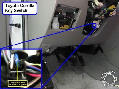

Keysense (-) key switch, black 2 pin plug, pin 2
https://www.directechs.com/DirectWirePrintPhotoNotesBox.aspx?VehicleID=5717&Item=ksense
2005 toyota corolla pkall bypass wiring -- posted image.

golfer2000
Member - Posts: 29
Joined: November 23, 2014
Posted: December 28, 2014 at 11:02 PM / IP Logged
That's awesome, I couldn't find it before but I will look again tomorrow and report back with my findings. Thanks to everyone.
