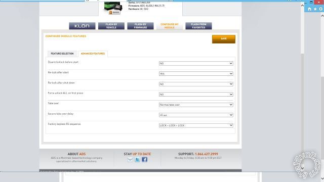

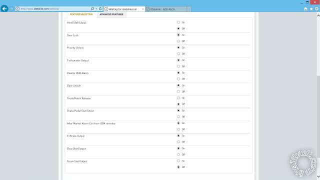

Here's a quick snapshot of the datalink settings:
2006 frontier idatalink / dbi interface - Page 2 -- posted image.

the rearm on the door pin will shut down any additional accessory circuits such as radio, and exterior lighting. its just how the vehicle processes information at the BCM. WHen it receives an unlock signal the dome light comes on. If you want the bed light to work, you would most likely need to hardwire that connection from the starter unit.
