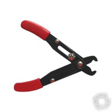

as I mentioned, tools can be used more than just installations, that's why I buy good tools that will last. Using a big beach towel ensures you loose no tools. Find what works for you. start with a good set of cutters and wire strippers, see what works best. I know among most installers, this is by far the most commonly used strippers. To each their own
tools -- posted image.
