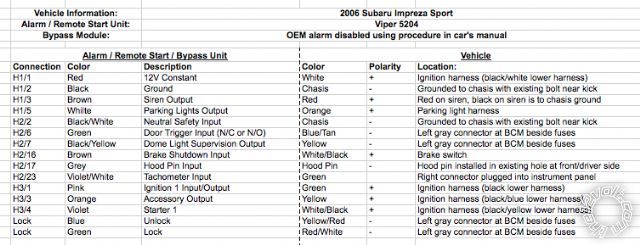

Here's everything I have wired to the Viper unit.
06 impreza w viper 5204 shows no voltage -- posted image.

1) I had poor lighting so accidentally connected a PURPLE / white starter wire to my horn instead of the BROWN / white horn wire. So I was getting the horn at each attempt to start.
