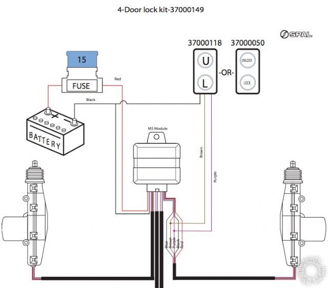

I have a 4x4 with working SPAL central locking - here is how it is wired:
avital 2101 and spal central locking -- posted image.

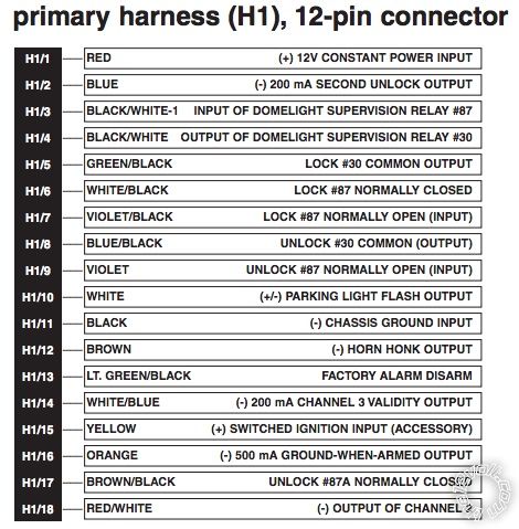

I'm trying to fir an Avital 2101 keyless entry kit to it, with the pinout below:
The SPAL central locking is triggered by earthing either the purple or the brown wire (to lock or unlock respectively).
I have wired up the 2101 with the main power, earth and ignition .. when I press lock or unlock on the remote I can hear the relays inside click, however (with a multi-meter) I'm not able to see either 12+ or earth on any of the H5 through H9 leads.
I'm a bit at a loss, I'm not able to find anything in the manual that talks about setting the polarity for the locks, just the parking lights. I'm generally pretty good with these things however the manual for this is quite poor.

violet and violet/black to ground, blue/black and GREEN/ black to the spal trigger wires
Ted
