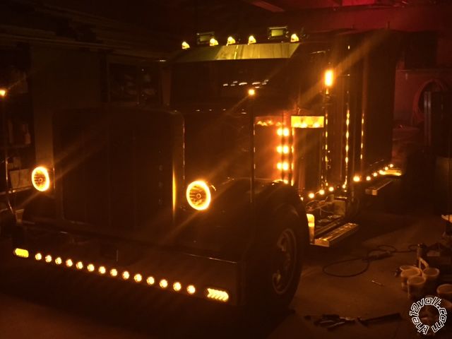

viper 211 hv, mini peterbilt -- posted image.
This is my truck--------
I'll get back with the results -- I hope soon.
Thank You,
WAYNES WORLD

Guys---- check out that lights only photo. This is the project thus far. Stay tuned -----
Thank You,
WAYNES WORLD
