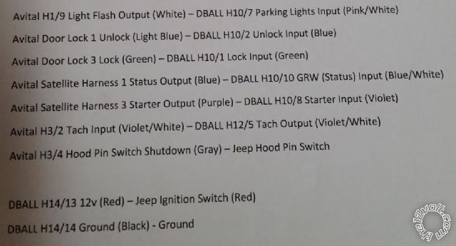

This is the checkoff list I used to make the connections. I also added the H1/6 (Brown) to the (Gray/orange) horn switch, which fixed the panic button feature. I also grounded the 6 pin of the 10 pin connector on the dball2 to chassis ground. I do need to wire the brake sensor wire that shuts down the remote start when the brake is pushed.
