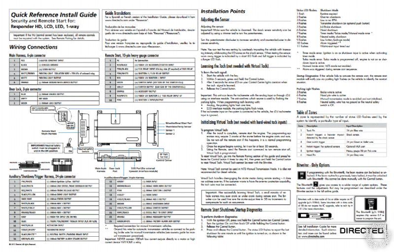

looking into install this into a Tacoma 2010. Which of this wire is 85, 86, 87, and 30
Relay for remote start -- posted image.
1st_handler
Member - Posts: 19
Joined: March 19, 2015
Posted: March 19, 2015 at 1:07 PM / IP Logged Link to Post Post Reply Quote 1st_handler
Picture is not clear, but it's for Viper 5706V alarm/remote start
