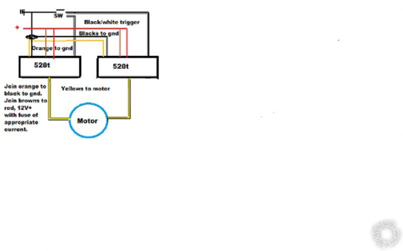

Posted: April 03, 2015 at 3:28 AM / IP Logged Link to Post Post Reply Quote howie ll
Here you go:- motor_control.png

Posted: April 03, 2015 at 10:36 AM / IP Logged Link to Post Post Reply Quote swedespeed7
Thank you! So how exactly do these 528t relays work? Do they sense when the motor has finished opening? Or is it strictly a timer?
Will a single button momentary SPDT switch work?
Posted: April 03, 2015 at 10:42 AM / IP Logged Link to Post Post Reply Quote howie ll
Adjustment pots accessible through the case, 1-90 seconds. You can see the relay contacts moving.
Method is to time the act of whatever you're controlling in either direction then add 1 second to each.

Posted: April 03, 2015 at 10:45 AM / IP Logged Link to Post Post Reply Quote swedespeed7
I see, that sounds perfect. And a single push button momentary SPDT switch will work for this? As in, I push the momentary switch once, the switch immediately releases, but the motor keep turning until open or closed position, correct?
Posted: April 03, 2015 at 10:50 AM / IP Logged Link to Post Post Reply Quote howie ll
You need a momentary centre off SPCO (aka SPDT) as I explained a above. A single push button won't do it. You'd need two. If your existing switch is spring loaded centre off, i.e. momentary action, like a window switch then remove the power supply feed it from ground, remove the existing ground the outputs then feed the 2 X 528t.
